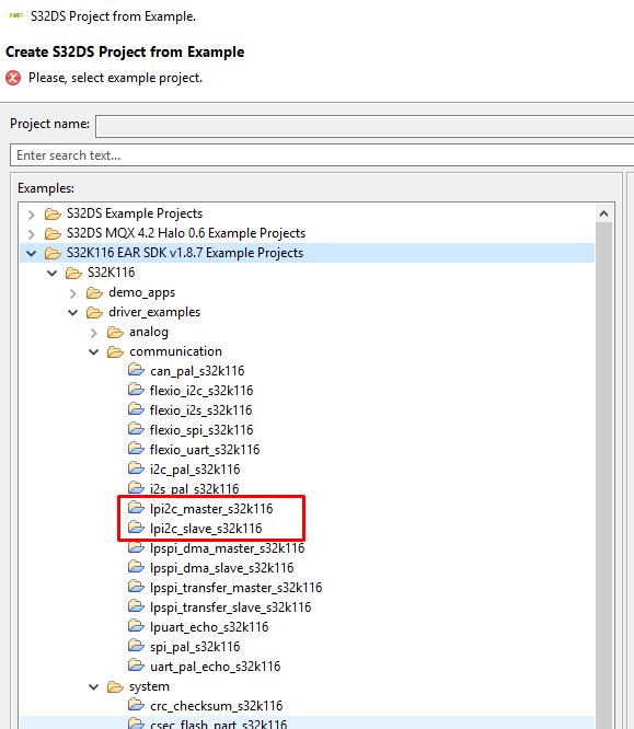

Where can i get sample code for I2c Drivers for Sk32116 controller?

Hi Ashish,
In the S32 Design Studio for ARM 2018.R1 the driver examples you can find in the
File-> New -> S32DS Project from Example as you can see on the picture below.
If you do not see it, is needed to update S32 Design Studio, see link:
S32 Design Studio for ARM 2018.R1 - Update 1 available
I hope it helps you.
