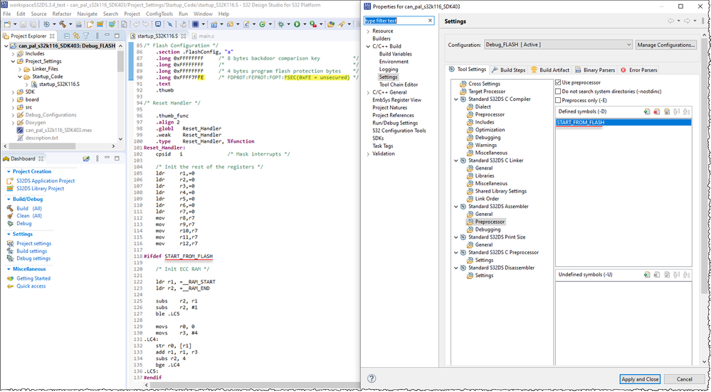

In addition to modifying the FSEC of Flash Configuration in startup_S32K116.S, are there any other changes?
If you just modify FSEC, I don't think it will cause this problem.
Maybe you can check if START_FROM_FLASH is defined.

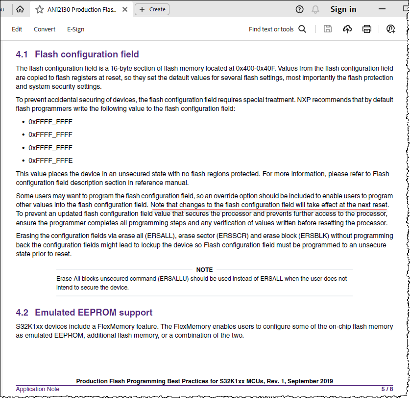

AN12123 mentions: Note that changes to the flash configuration field will take effect at the next reset. Have you try to read back through the JTAG port before reset MCU?
In addition, when reprogramming, how about enable backdoor key feature so that temporary unlocking MCU then read and verified through the JTAG port?
