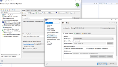

I created a simple project of S32K116 for blinking LED by using S32DS 3.4, the program can be downloaded successfully and the S32K116 works well in Debug_FLASH mode with PEMicro tool。
However,  the program cannot work after power off and power on again, and it's like the program is only downloaded to RAM.
I created a second same project using S32DS 2018.R1, and the S32K116 works well.
The Debug_FLASH configuration in both of the projects uses the default parameter.

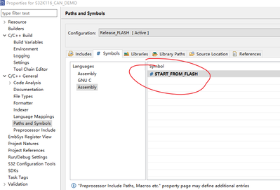

Thank you very much for your reply. I created an example code using S32DS 3.4, and I found the difference in configurations between the example code and my code.
There is no #START_FROM_FLASH in my code and after I added the symbol in my project my code works well. I don't know why although I created my project using the default configuration.
