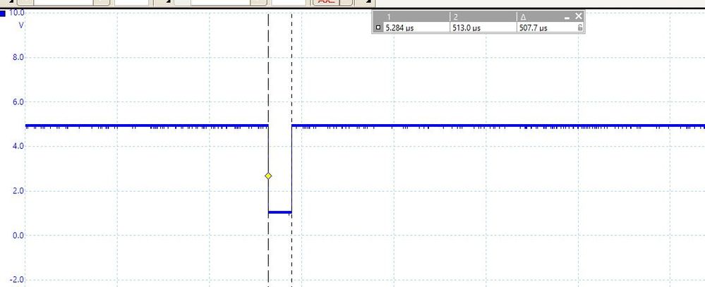

Hello
    I meet a issue: the reset signal could not reset MCU.
    when I measued the pin reset, find that The voltage of the reset signal is 1V and the time is 500us,and the supply voltage of MCU is 5V.
    But I see the datasheet the range of low voltage  is 0-0.3VDD,so the I and hardware engineer all think the hardware design meet with the datasheet.
    so what is the requirement of the reset signal of MCU s32k116? could you tell me the corrent answer?

asd046012
This issue has been solved, the pull-up resistance 22K has been replaced to resistance 22 by supplier, cause the level to not be low.
 I have used the resistance 22K to replace the resistance 22,the reset signal is normal.

asd046012
Hello
   The wave of reset signal measured by oscilloscope is as below.
    The signal RESET_SBC is input signal for the MCU,  and output by SBC,  so the reset signal is controlled by SBC.

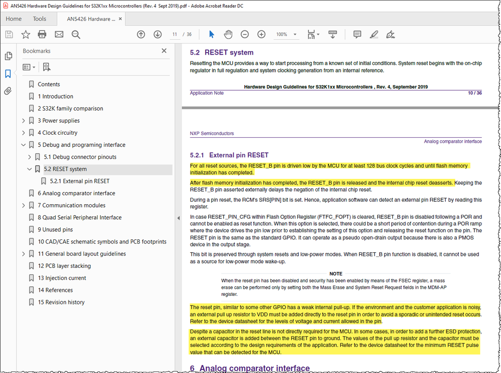

Robin_Shen
Hi asd046012,
Please refer the "5.2 RESET system" of AN5426, Hardware Design Guidelines for S32K1xx Microcontrollers
After flash program into the MCU, this phenomenon will no longer appear on the reset line.
