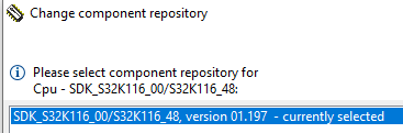

I'm using S32DS with S32K116EVB board.
I have update the SDK with S32SDK_S32K1xx_RTM_3.0.0.
I imported the freertos example but Processor Expert cannot find the associated package for S32K116:
Could you please tell me how to had the package?
thank you.
1 返信
1,720件の閲覧回数
antoine_monmarc
Contributor V
To fixed my issues I had to right click on the "Cpu:S32K116" and select "Change Repository..." to select another valid repo.
I noticed that the FreeRTOS components is not available in the repo I'm now using:
