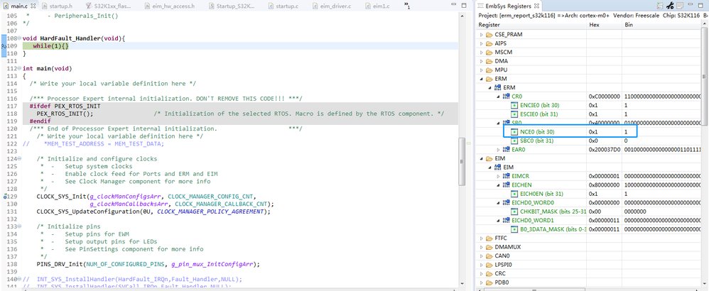

Helloyt
    I tried to test the action of ERM after an double bit ECC error occured(none-correctable),to my understanding,in S32K116 ,after an double bit ECC error occured the hardfault_handler will first be triggered ,and user can add some code to the hardfault_handler to deal the error flag in ERM
    but when i injected an double bit ECC error to SRAM_U, the SRAM was dirrectly cleared with the vector_table in SRAM reset to 0x00000000 ,and after an hardfault_handler trigger ,the pc(core register) jumpt to 0x00000000 to fetch code ,and then ,the program crashed.
    as you know , stack locte in S32K116'SSRAM_U ,therefor ethe double bit ECC error will be triggered in EIM_DRV_Init() first ,following is the debug info before enable EIM module
  • pic1
    I redefined NMI_Handler,HardFault_Handler at following code ,so their func address in SRAM is not default value(WDG_Handler,0x46d)

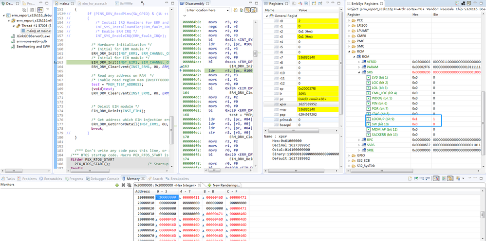

  • pic2

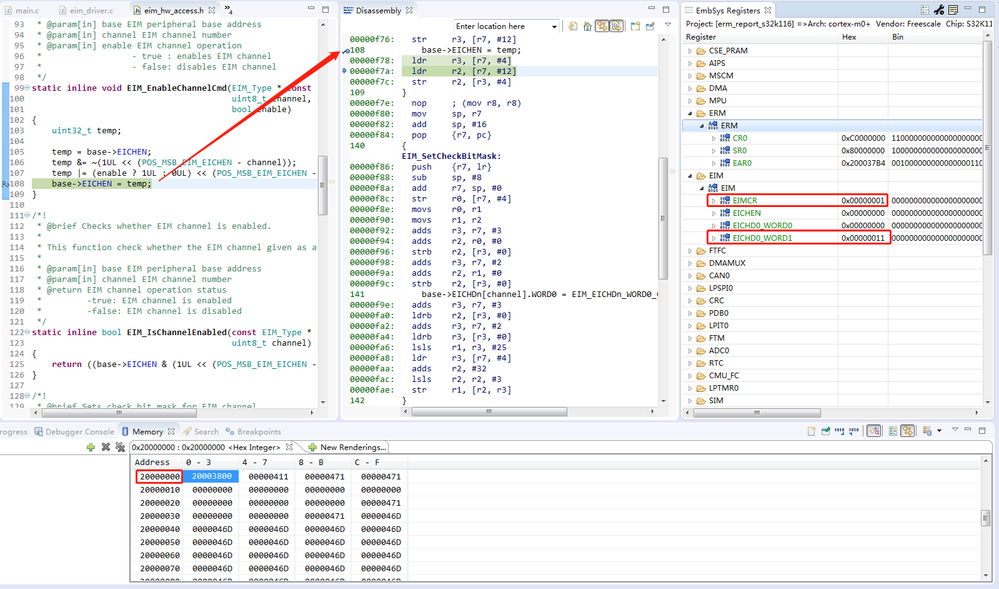

    to describe the problem in detail ,the code line before trigger ECC double bit error will need to change to disassembly view as you see in pic2(no breakpoint in the program also will cause crash)
    the SRAM was cleared,and the register xpsr == 0x81000000 ,which mean no interrupt triggered,the same time(or before SRAM cleared) the ERM NEC0 was set to 1

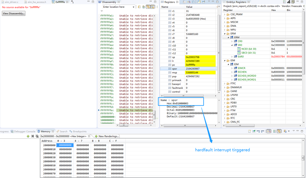

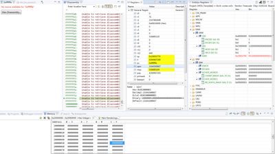

  • pic3

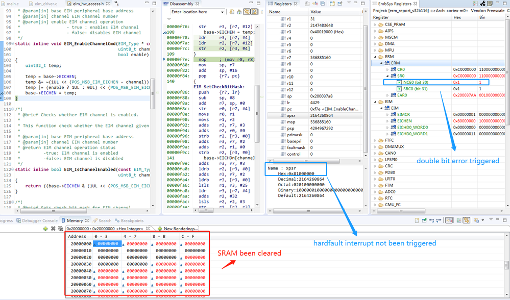

   then,go on signal step debug, xpsr == 0x81000003 ,it seems an hardfault_handler interrupt was triggered and the program crashed
  I guess that after xpsr change to 0x81000003 the pc(register) will go to SRAM address 0x2000000c to fetch the entry of hardfault_handler,but as you see, the SRAM was cleared by some reason,at the end ,the program crashed because the error address
  so,what caused the SRAM cleared ,and what should i do to deal double bit error in hardfault handler?

danielmartynek
Hi @Helloyt,
When the MCU detects a non-correctable ECC error, it fetches the HardFault_Handler vector (or BusFault_Handler if enabled).
But because the vector is in SRAM_U, it detects another non-correctable ECC error during the vector fetching.
And this escalates the hard fault exception to Core Lockup.
Can you leave the vector table in the flash?

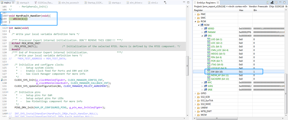

Can you read the MCR_SRS[LOCKUP] flag?
4,633 Views
Helloyt
Hi ,@danielmartynek
  I think your mean is to supervise the LOCKUP flag in  System Reset Status Register (RCM_SRS) ,following pictures shows the change  of RCM_SRC[LOCKUP]
  • pic1 before ecc error occur
  • pic2 a reset occured
the picture2 shows the core was lockup , but I not sure whether the NULL vector caused core lockup or the ecc double bit error caused core lockup with SRAM cleared.

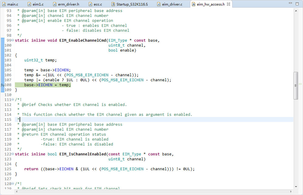

p.s. I found that this time the ecc error triggered after the EIM gloale enable instead of EIM channel enable yesterday ,with little code changed.

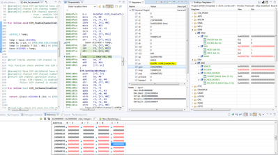

Helloyt
Hi @danielmartynek ,picture illustrated above are displayed in a better way here ,and you can read problem described above for detail
  • pic1 before inject double ecc error
  • pic2 jump into EIM_DRV_INIT()
  • pic3 change view to assembly code meanwhile supervise the  SRAM content
  • pic4 ecc double bit error occur , SRAM had been cleared and hardfault interrupr had not yet been triggered
  • pic5 hardfault triggered but SRAM content (vector address) is NULL ,thus the program crashed

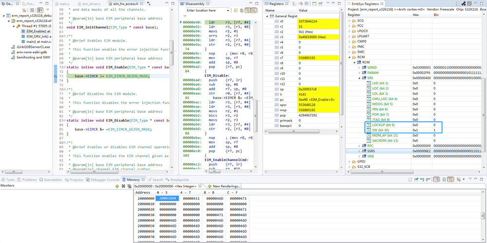

usually ,to reflect the real register action ,breakpoints should not set in step,so the 2 pictures above show the same program without breakpoints in middle process
  • pic2 mcu reset and program run to the same breakpoint
