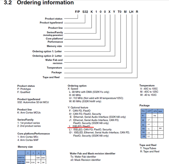

Does S32K116 support 2Mbps CAN FD with FIRC?
CAN 1x with 116 and 118 models tied to the data sheet
It says (1x with FD), but CHAT GPT informed that S32K116 does not support CAN FD, but from S32K118 onwards model, CAN FD is supported.
I'd like to know a clear answer.

Hi@Oido
No, for S32K116LIV,it does't support CAN FD

FS32K116LAT0MLFR If I use this model, will I be able to use both CAN-FD and PWM?

Hi@Oido
There is noting to do with PWM, PWM can be generated from FTM module.
FlexIo module can also used to generate PWM.

In conclusion, by replacing FS32K116LAT0MLFR with model, is it correct that I can use PWM with Flexio function and CAN-FD (2M 64byte) instead of classic-CAN (500K 8byte)? I haven't heard back about CAN-FD yet.

Hi@Oido
yes, this part number can support FLEXIO and CAN FD.

In my MCU, the letters are written like S32K116LIV.
