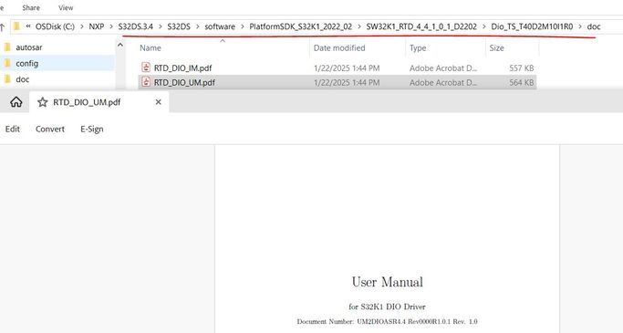

From where can I find or download full API documentation for the S32K1(44) RTD?
Like, in examples I have Dio_WriteChannel - where do I find its documentation?
Also: is there another set of documentation for lower level hardware? If I want to do direct register manipulation like PORTD. I think I was able to use PORTD in the non-RTD SDK.
1,031 Views
Senlent
Hi@bananium
For S32K1 RTD, the User Manual for each Component can be found in the Install Path.
Such  as for Dio.
