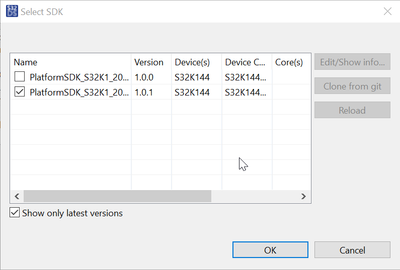

laofu
Hi @Vasily_Wu
I have installed the RTD succeed ,but i can not choose this RTD as the sdk when i new a s32k144 project, can you help me? thank you very much.
5,818 Views
Sandeep123
i can not choose this RTD as the sdk when i new a s32k144 project.
