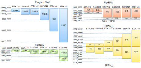

please can you explainning a Flex NVM and Flex RAM spaces?

Hi@lim,
there is an example "flash_partitioning_s32k1xx" in S32 DS.the purpose of this demo application is to show you the usage of the Flash Driver with the S32 SDK API.
The example does the following operations:
-Paratitions the flash
-Configures FlexNVM region as EEPROM
-Programs flash
-Write data to EEPROM.
Application Note related to FlexNVM
AN12003 Using S32K148 FlexNVM Memory – Application Note
AN11983 Using the S32K1xx EEPROM Functionality – Application Note
Above application note can be found in below link.
https://www.nxp.com/products/processors-and-microcontrollers/arm-microcontrollers/s32k-automotive-mc...
BR!

Hi@lim
Are you looking for this?
More S32K1xx Memory Map information could be found in S32K-RM attachments:S32K1xx_Memory_Map.xlsx.

Thanks. I want to know how these spaces are used in the system.( Flex NVM,RAM)
