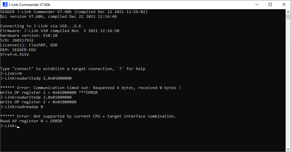

I tried to communicate with MCU via J-Link Commander with no success, as on screenshot.
I didn't check with oscilloscope if RESET line is driven properly, I'll do it tomorrow(lack of time, sorry).
I see two interesting things:
  • first attempt to write MDM_AP register always fails, second looks like successfull but I'm not really sure if it is successfull
  • it looks like my version of J-Link doesn't have full SWD support
BR, Witold

danielmartynek
Hi @krzemowy,
You have to use the "connect" command first, as suggested by the commander.
Then, it will ask you a few questions, like the speed of the connection etc.
BR, Daniel
