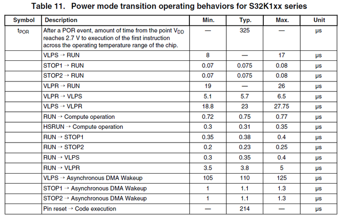

Please note that it takes some time to transition between RUN modes and STOP modes as specified in the datasheet,
