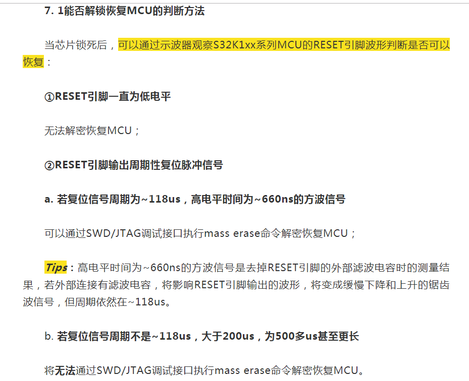

In the process of using S32K, MCU locks up. I follow the operation of the following website or not. The website is S32K MCU LOCK Resolvent
My third case is that if the reset signal period is not ~118us, greater than 200us, more than 500 US or even longer, I don't know what can be solved?

Hello Mr. Liu,
I am the author of this document you mentioned above.
As said in the document, if the reset signal period is not ~118us, greater than 200us, more than 500 US or even longer, the device is locked forever and cannot be unlocked and recover any more.

liulei1
Thank you,I want to know if there will be this problem in the actual operation of the single-chip computer. If it happens, it will be disastrous. How should we avoid it in the design?
