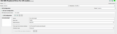

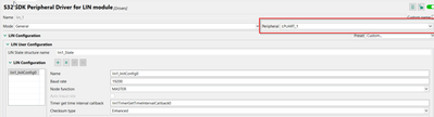

I use the S32K148 LIN driver, the setting  is master and baud rate is 19200 as below picture show:

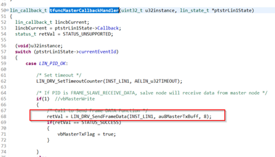

I use the method as below:
1. send the header first:
2. then in the callback function: send the content:

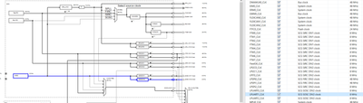

I change the LPUART1_CLK as you recommend, see below photo:
linton_0-1720057407632.pnglinton_0-1720057407632.pnglinton_1-1720057444880.pnglinton_1-1720057444880.png
the waveform is almost the same, did not have any improvement.
I also try the other 3 clock as below show:
the waveform almost the same, so I have to do next to fix this issue??
