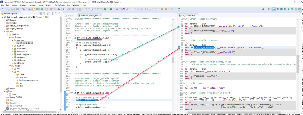

Hello, I have a question about the interrupt function process: If I don't need interrupt nesting, is there need add disable interrupt at the first of interrupt function, then add enable interrupt at the end of interrupt function? Thank you!

Hi wanglijun,
Please check the ENABLE_INTERRUPTS() and DISABLE_INTERRUPTS() functions.
ENABLE_INTERRUPTS DISABLE_INTERRUPTS.pngENABLE_INTERRUPTS DISABLE_INTERRUPTS.png
Or maybe you can set all interrupts to the same priority.

Robin_Shen
There is no register for enabling or disabling interrupt nesting. In addition, enabling and disabling interrupts is a register of the ARM Cortex core. I suggest you read this article: Cutting Through the Confusion with Arm Cortex-M Interrupt Priorities

Robin_Shen
Hi wanglijun,
The default interrupt priority are set to 0, so there should no interrupt nesting happen unless you reconfigure the interrupt priority by using INT_SYS_SetPriority() function.
