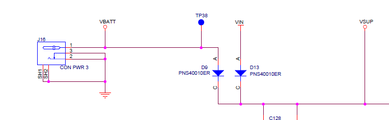

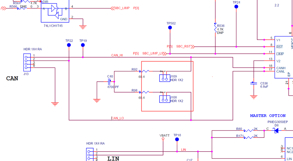

1  What is the state of J108 and 109 ?
How much voltage is Vbat?
6,056 Views
PetrS
J108/J109 are placed and Vbat is 12V.
BR, Petr
6,056 Views
xiabin
thank you!
The reason for the error is that I used vbat 5v。
