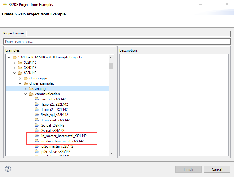

I recommend you refer to the example lin_master_baremetal for the S32K142-EVB of the SDK 3.0.0. In this example, the Master sends FRAME_MASTER_RECEIVE_DATA header and asks to the slave node responds by sending data. You could use this example as a base to see what you are missing on your project.

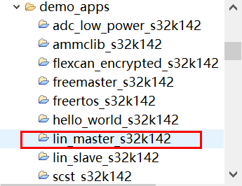

  The example only use the lin api,but I don't use sdk.I program by reference mannual.I want to know how to operate the LPUART registers.
  My question is the exceptional 'rdrf' status in register 'LPUART->STS'.  It is setted to '1' for several times,when I transmit data.
  I don't know whether the example in picture is right or not.If it is not the example you said ,please give me a url to download it.

Within the SDK instead of going to the demo_apps folder, go to driver examples  > communication, in this path you will find a baremetal example of LIN Master.
