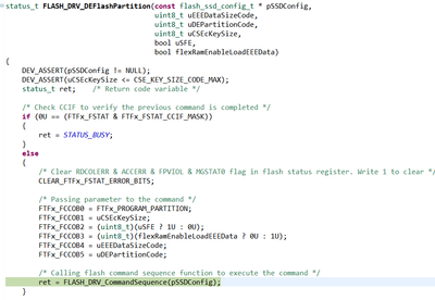

Hello,I am using s32k1xx.I have  found a issue about the"FLASH_DRV_CommandSeque"when it launched in different  memory block.
I knew that when used " __attribute__((section (".code_ram")))",it would be launch in RAM.I I wanted to know if I can still use flash erase command or program command if I delete this definition.Then I have found the issue:

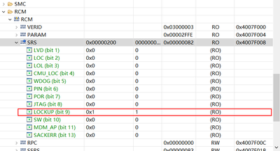

1.When the program runs to  eee Initialization function "FLASH_DRV_DEFlashPartition➡FLASH_DRV_CommandSequence",mcu will reset.Reset source is "LOCK UP".I used the "step over".
2.Before mcu reset, I used the "step into" to run "FLASH_DRV_CommandSequence".The program will run normally and also I debugged the same program again,issue 1 that I described earlier will not happen.
3.In issue 1 and 2 process,the FTFC_FSTAT is normally.CCIF is 1 before every memory commands.

1.In issue 1 when I used the "step over" to run eee Initialization function,Why does the MCU reset?
2.In issue 2 when I used the "step into" to run "FLASH_DRV_CommandSequence",Why can the program run normally?Why I debugged the same program again,issue 1 that I described earlier will not happen?

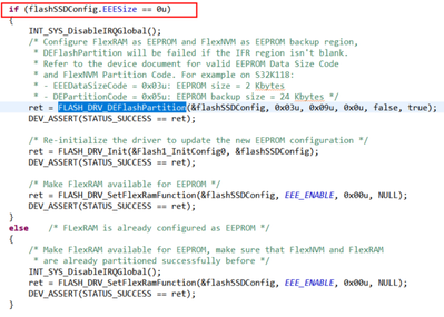

Actually,I have partitioned my device before.I just  debug a new program the only difference between it and  the original program is deleted the "__attribute__((section (".code_ram")))".
In both programs,I also have read the partition information when I  prepared for  EEE initialization,just like the screenshot .
Does this issue occur when a new program is debugged? Perhaps my judgment method is incorrect?I think the point of issue is  about "FLASH_DRV_CommandSeque".
