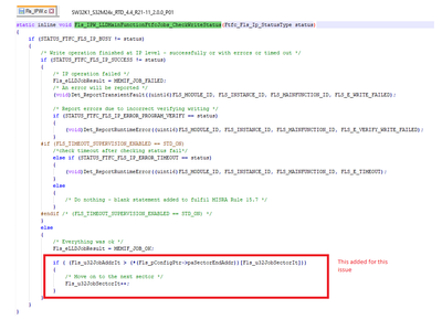

When data is written to D-flash, the allocated cluster is often not fully written, but the cluster is frequently switched. The reason is that when the remaining space of the written object sector is less than the length of the next data to be written, FEE will judge that the end address of the next write data is greater than the end address of the current sector. An error is then reported in FEE, causing the entire erase switch of the cluster to occur. How to avoid this situation?

Which version of S32K3 are you using? Because as far as I know, this issue was fixed from SW32K3_RTD_4.4_R21-11_3.0.0_P01. So, you can try to refer to it.

For K1, please try to upgrade to the package SW32K1_S32M24x_RTD_4.4_R21-11_2.0.0_P01. I saw that your issue fixed at this version.

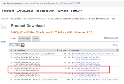

Do you have any idea about where can find the release note which include the update detail between this two version ?

You can find the release note for each package in which you downloaded that package. For example: https://nxp.flexnetoperations.com/control/frse/download?agree=Accept&element=3592883
For your issue, this was made:

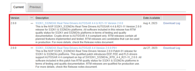

Where can we download the package of this two versions? ( S32K1_S32M24X Real Time Drivers AUTOSAR4.4 &R21-11 version 2.0.0 / S32K1_S32M24XReal Time Drivers AUTOSAR4.4 version 2.0.0 P01)
3,809 Views
HuitingXu
We need your opinion on the version replacement, which S32K1_S32M24X Real Time Drivers AUTOSAR4.4 &R21-11 version 2.0.0 or S32K1_S32M24XReal Time Drivers AUTOSAR4.4 version 2.0.0 P01 is more suitable instead of S32K1_RTD_4.4_1.0.1_HF01_D2209? Or what's the difference between this two versions?

You can download at: https://are.nxp.com/FlexNetCatalog.aspx
From my point of view, have no significant difference between these 2 packages but my suggestion is the latest version.
