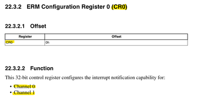

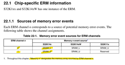

Regarding Error Reporting, the latest Reference Manual for S32K (Rev. 12.1, 02/2020) states that the mentioned register is used only for RAM error reporting. Is this not the case?
André
7,020 Views
lukaszadrapa
That's a good point, you are right. Sorry, I mismatched that with another devices where it is possible.
I just confirmed that there's no flag for single bit error. Only double bit error can be reported on flash.
