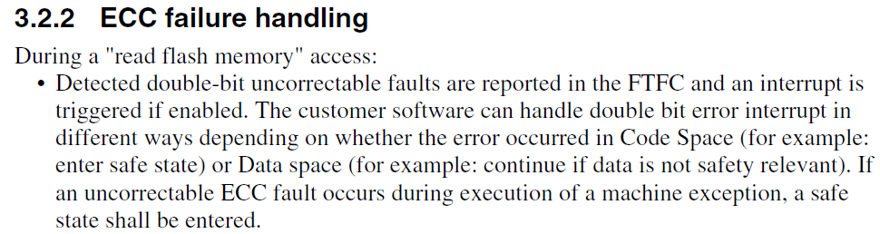

I am using S32K118 EVB. According to the safety manual, reading flash memory can detect the double-bit uncorrectable error.
My question: is there a way to cause a double-bit uncorrectable error in the flash memory via SW?
Thank you for your support.

Hello Sherif,
Yes, it can be done by two subsequent writes (program phrase command) with different data at one flash address (phrase). Normally, the phrase must be erased before the second write. The ECC error then depends on the resulting phrase value and ECC checksum value. Then, if you read the address, ECC error will be reported.

Hi  Daniel,
I followed your advice and yet I observe FTFC_FERSTAT remains 0 after the read to location.
The function below writes 8 bytes to location 0X0D2660 (0XAA,0X55,,,) which is 64bit aligned and then it erases it and writes 0x14,0x13,0x12......
then I read the location 0x0d2660  and look at the register I mentioned above and it still is 0x00
This function flsh_ecc run out of RAM from 0x1FFE0000 which is at top of the ram also  the debugger shows me the 1st phrase is written and then erased and rewritten with a new phrase.
then I read the location:
myvar = *((unsigned long long*)0xd2660);
the only thing which is notable is :the code hangs up up and won't run anymore.

Just wondering beside the register FTFC-FEPRT is it some else th check.
BR,
kOOROSH
4,304 Views
hajianik
Senior Contributor I
Hi Daniel,
I guess it hits the Memory fault exception when It hangs up.
There is no reset causing mechanism for this exception handler. I did not write the code for it. it is all in assembly and good luck deciphering it.
