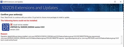

is there a lin stack for s32k344 MCU on s32k DS 3.4?

I tried to install the lin stack on s32k ds 3.4 and I got the following error, do you have any ideas how to correct it?

PetrS
seems S32K3 RTD 0.9.0 package is missing, so please install it too.
BR, Petr
5,085 Views
PetrS
we do have LinStack for S32K3 but it is not in the RTD package. Could you please find it in the https://www.nxp.com/webapp/swlicensing/sso/downloadSoftware.sp?catid=SW32K3-REFSW-D
