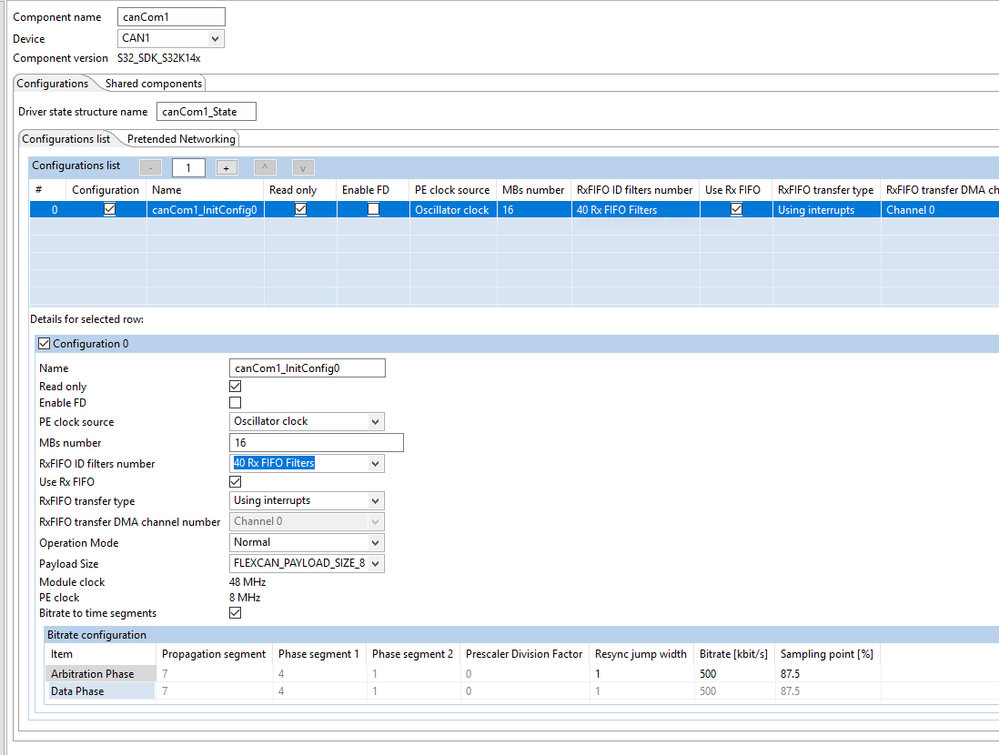

Hello Daniel,
I have looked over your case and based on the scenario you presented you need about 80 filters this can be done useing filter type B and 40 filters this configuration will require all 16 Mbs available for CAN1 instance on S32K144 for RxFIFO, no other MB will be available for other operation.
Here is the driver PEX configuration
Here you have an example that will config the filters and then initialize the Driver.
void FlexCANInit(void)
flexcan_id_table_t idtable[80];
uint16_t id=2;
for (;id<0x50;id++)
if ((id == 0x4d) || (id == 0x4e))
idtable[id-2].id = 0x44f;
idtable[id-2].isExtendedFrame = false;
idtable[id-2].isRemoteFrame = false;
else
idtable[id-2].id = (0x400+id);
for(;id<80;id++)
* Initialize FlexCAN driver
* - 8 byte payload size
* - FD enabled
* - Bus clock as peripheral engine clock
FLEXCAN_DRV_Init(INST_CANCOM1, &canCom1_State, &canCom1_InitConfig0);
FLEXCAN_DRV_SetRxMaskType(INST_CANCOM1,FLEXCAN_RX_MASK_GLOBAL);
FLEXCAN_DRV_ConfigRxFifo(INST_CANCOM1,FLEXCAN_RX_FIFO_ID_FORMAT_B,&idtable[0]);
The read can be done from RXFIFO of received messages that will match between 0x402-0x450 without 0x44e and 0x44d.

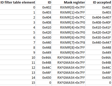

Hi Daniel,
I have tested the filtering based on below example I did some time ago.
https://community.nxp.com/docs/DOC-343091
Attached is the main.c file you should use to implement ID table I proposed. Using this code the RXFIFO accepts only standard IDs in range 0x402-0x450 except of IDs 0x44D and 0x44D.
I found one mistake in my proposal; mask for ID element 3 should be set to 0x7F8 instead of 0x7F0.
Also bit 30 in mask register must be set so IDE bit checked, otherwise also some extended IDs will be accepted
Similar should be valid for bit 31 masking RTR.
Thus I used below code to set the mask registers properly.
uint16_t IDmask[10] = {0x7FF,0x7FF,0x7FC,0x7F8,0x7F0,0x7F0,0x7F0,0x7F8,0x7FF,0x7FF};
/* set individual masking type */
FLEXCAN_DRV_SetRxMaskType(INST_CANCOM1, FLEXCAN_RX_MASK_INDIVIDUAL);
for(id_counter=0;id_counter<10;id_counter++)
FLEXCAN_DRV_SetRxIndividualMask(INST_CANCOM1, FLEXCAN_MSG_ID_STD, id_counter, 0xC0000000|IDmask[id_counter]);
/* rest of filter items are masked with RXFGMASK */
FLEXCAN_DRV_SetRxFifoGlobalMask(INST_CANCOM1, FLEXCAN_MSG_ID_STD, 0xC0000000|0x7FF);
BR, Petr

Hi Daniel,
The CAN_MCR[IRMQ] bit determines which mask register is used for the RXFIFO ID table elements. If CAN_MCR[IRMQ]=0 then all ID Table is affected by RXFGMASK. If CAN_MCR[IRMQ]=1, elements in ID table are affected by Individual Mask Registers (RXIMRx) according setting of CTRL2[RFFN].
There is bit2bit correspondence between received ID, mask and programmed MB ID or ID Table element. The mask says if corresponding incoming ID bit is compared with programmed ID bit.
If mask bit is cleared the incoming ID bit is not compared, it is don’t care. If mask bit is set, then there must be exact match between incoming ID bit and programmed ID bit. To receive a message into a MB/RXFIFO all bits with mask bit set must be equal to programmed one.
So assuming the above, mix of dedicated ID and ID ranges should be used within ID table. Below config can be used assuming CTRL2[RFFN]=1.
BR, Petr
