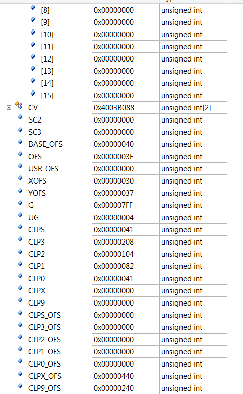

I configured the ADC program, the voltage value and the result of the routine in S32DS are different by 0.9V. Why is this? Is it because I am using software triggering, is the routine using hardware triggering?

Register result as so:

Have you calibrated the ADC module?
It doesn't matter whether you use HW or SW triggers.
But it depends on the signal that you are measuring, the sampling rate, Rs, Cf...
Please measure the signal with an oscilloscope.
