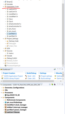

I wonder if there is an errata for S32DS arm 2.2 version.
The S32DS I am currently using is shown in the photo below.
If you look at ProcessorExpert's clockMan, you can set DIV for Run/VLPR/HSRUN Mode in Interface clocks.
However, when I generate the value set through the UI, it does not match the value displayed in the actual code.
Is this an errata? Or is it handled separately by the sdk driver?
thank you
sungjun_1-1706674455162.pngsungjun_1-1706674455162.pngsungjun_2-1706674518933.pngsungjun_2-1706674518933.png

Senlent
Hi@sungjun
Only the files in this folder are configuration files generated by S32 DS

sungjun
File name : clockMan1.c
Sdk :
S32 Design Studio for ARM
Version: 2.2
Build id: 200116
Copyright Freescale Semiconductor 2016. All rights reserved.
Copyright 2017-2020 NXP
Visit http://www.nxp.com/
This product includes software developed by the Eclipse Foundation http://www.eclipse.org/
This product includes software developed by the Apache Software Foundation http://apache.org/
The related information was written using the photo in the first question. Can't you see it?

sungjun
The question was why the Div numbers in the photos were different.
After checking again, it appears that the SDK UI is a DIV based on SPLL and clockMan1.c is a DIV based on the system clock.
It is also divided into SYS_CLK in RM's Blockdiagram.
Is that right?

sungjun
Thanks to you, my problem was solved.
I would like to ask one more question.
I also want to check like the picture below, where is the data?
