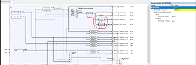

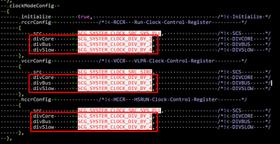

If you look at ProcessorExpert's clockMan, you can set DIV for Run/VLPR/HSRUN Mode in Interface clocks.
However, when I generate the value set through the UI, it does not match the value displayed in the actual code.
Is this an errata? Or is it handled separately by the sdk driver?

Hi@sungjun
This picture comes from S32 Design Platform V3.4 & RTM 4.0.X.
you have to install the above IDE and SDK then you can see the picture in clock setting page.

I know. can you see above picture and compare SDK UI div value and c code.

File name : clockMan1.c

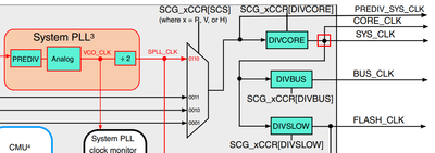

The question was why the Div numbers in the photos were different.
After checking again, it appears that the SDK UI is a DIV based on SPLL and clockMan1.c is a DIV based on the system clock.
It is also divided into SYS_CLK in RM's Blockdiagram.
Is that right?

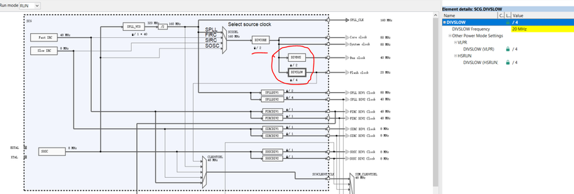

I would like to ask one more question.
I also want to check like the picture below, where is the data?
