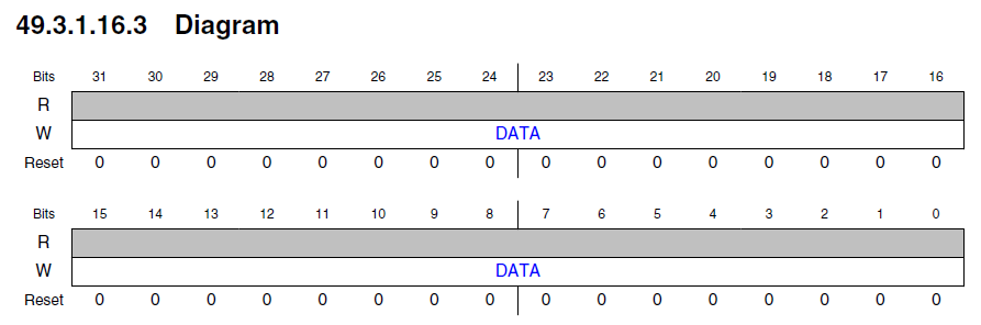

      I have a problem that has troubled me for a long time. I used S32DS to generate SPI code. But I found that MISO and MOSI have no signals, but SCK and CS have signals, I think my SPI configuration should be no problem, maybe there is a problem with data assignment. So I went to the TDR register but...   I found that there was no value in the register, but I was clearly calling the assignment statement. In addition, when debugging step by step, you can see that the TDR registers have been assigned.

The Transmit Data Register is a write-only register.

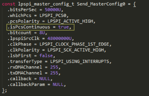

Do you want to use Continuous Transfer?

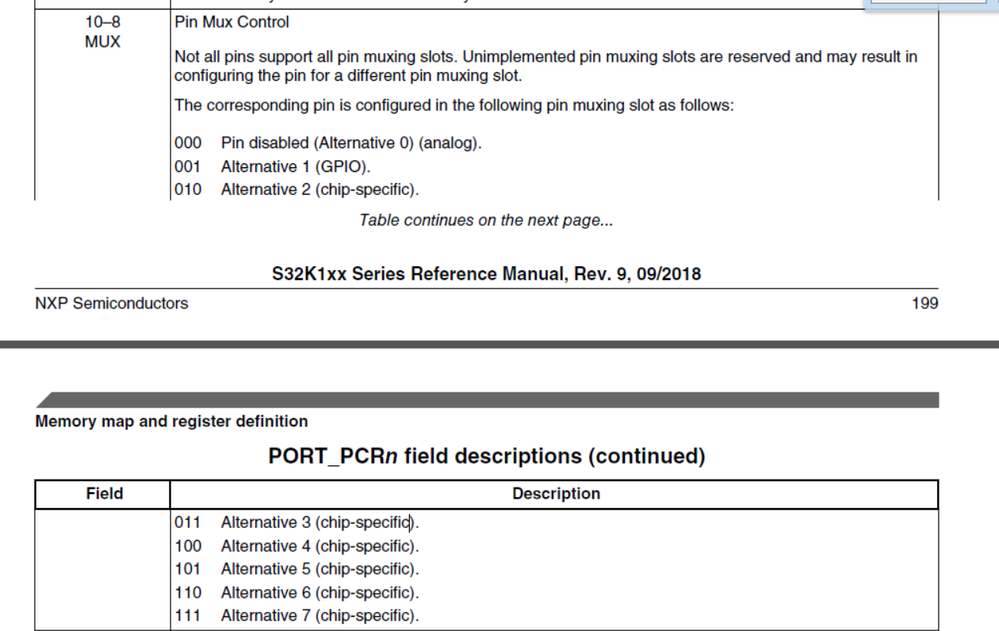

Please check the PCR[MUX] of the ports with the debugger.

Thank you for your answer. Actually, I don't quite understand what "Continuous Transfer" is, but if I assign this value to false, MISO and MOSI still have no signal. Then I checked the corresponding pin of S32DS and found that he was wrong, so I changed the pin again and finally saw the waveform on the corresponding pin of S32DS.
I still have a few questions that I hope you can answer.
1. Why is the pin corresponding to LPSPI0 routed to LPSPI1 in the S32DS (this is where my program had problems before)
2. PCR [MUX], we can only know two of these functions, but there are five other chip-specific. What does that mean?

During a continuous transfer the CS is kept asserted between frames.

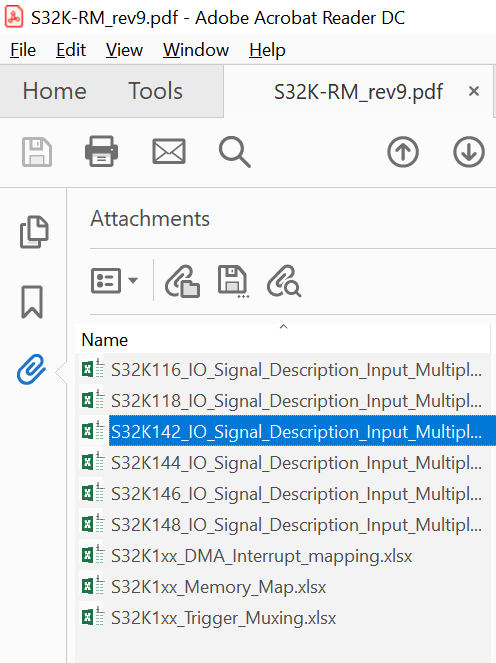

The alternative functions of the ports are listed in the S32K142_IO_Signal_Description_Input_Multiplexing.xlsx
that is attached to the RM.
