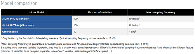

narsimh_kamath
Thanks @Senlent !
  • Is there a specific debugger and any specific debug interface of S32K1 that is needed for the approach you outline above?
  • Does it have any constraint in terms of number of variables that can be viewed in real-time?
2,683件の閲覧回数
Senlent
Hi@ narsimh_kamath
The debugger is the J-LINK series from SEGGER, such as J-LINK PRO or Plus, etc.
For more details you need to seek technical support from SEGGER.
https://www.segger.com/products/debug-probes/j-link/tools/j-scope/
You can see that the number of variables and sampling rates that different J-LINKs can support for observation are quite different.

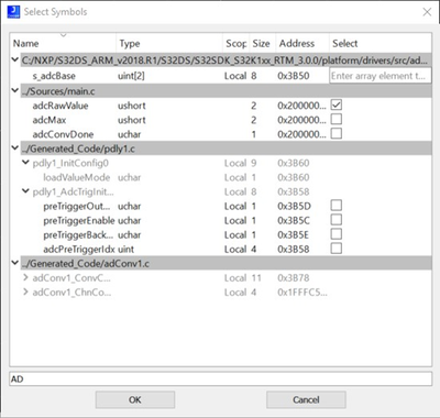

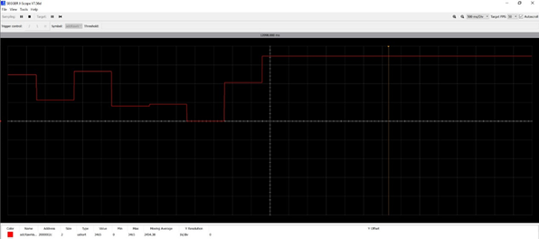

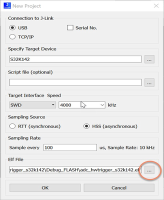

Senlent
Hi@narsimh_kamath
The S32 DS does not have such a GUI to view variable waveforms, but J-SCOPE is a third-party tool that can still be used with the S32 DS.
You only need to import the ELF file.
