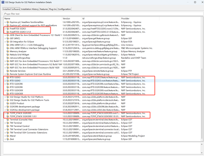

RTD:3.0.0
S32DS:V3.5
Hi,NXP
I am using the IDE's own tcpip_stack, after loading the components and configuring the relevant Settings, the compiler appeared the problem, trying to find the cause, and finally did not solve, want to ask NXP engineers, the problem is not because a setting is not paired, resulting in errors, please help to point out, thank you ~

Hi shunyizhang,
Sorry for this inconvenience.
Please help me try workaround this error by delete this warning flag
Please give me exact version of RTD and tcpip_stack version that you're using. About DS, which update site version of DS that you've installed?
I understand you're using RTD example or any project?
Please give me details for checking directly.
Thank you,
Nam.

shunyizhang
The compiled project is my own creation, RTD, S32DS, tcpip_Stack version see the picture above.

NamLee
Thanks for your quick response.
I understand that you are developing for K314 with TCPIP_stack 1.0.3 HF01 (latest). Is it possible if you can share your project to me?

shunyizhang
Yes, I am creating a tcpip project based on S32K314; Since the company's computer has encryption software, I can't share my project for you to review, but I can share the screenshot to you, see the picture above, I only added these components, after the configuration, the initial compilation alarm appeared, but I repeatedly consulted the contents of the components, and never found the configuration that can eliminate the alarm.

NamLee
I checked with the lwip example and compile it, i added RTOS simply like you. The compiling done without errors.
I installed K3xx dev package, K3 3.0.0 P07, DS update site 3.5.2, service pack EAR2, then RTOS 10.5.1 and tcpip_stack 3.1.0
Did you tried with K344 one? Is that the same issue happened?

NamLee
Also, please help me to try:
- Increase this param higher than 0.
- Remove Warning flag mentioned in compiler errors.

shunyizhang
I've solved the problem. This place can't be zero.
