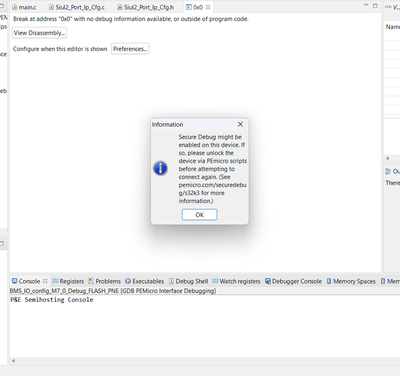

We are using s32k322 controller. PEMicro used for flashing the code into controller. While we tried to flash the code at very first time, window pop up the below error.
Let me know how to resolve these issue.

Hi @LavanyaR
this is rather general message which says that debugger can't establish the connection ever. Do you have more boards? Are all of them failing? Is reset signal deasserted after power on?

Issue resolved
