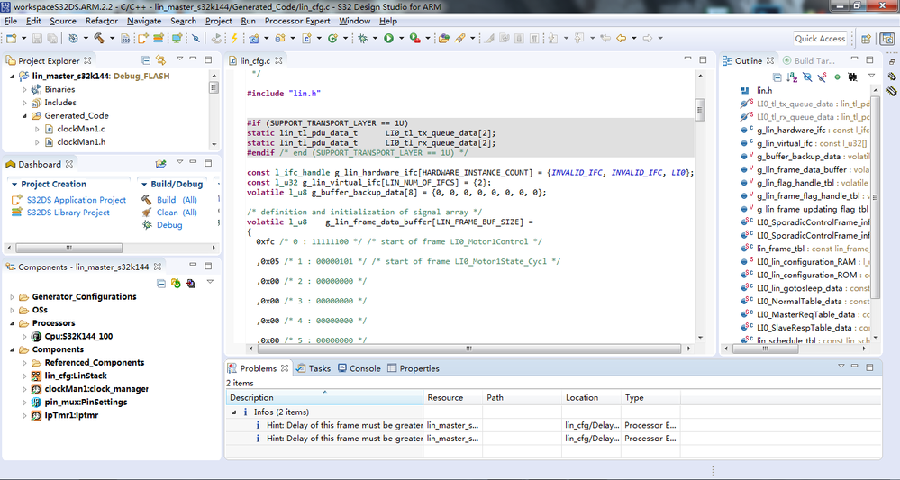

When I use S32DS create project from example,I find the processor code can not be generated correctly, which only happen in lin_master_s32k1xx & lin_slave_s32k1xx.
I do nothing but click the "Generate Processor Expert Code" button. Then build these projects.The errors are listed as below:
Errors
Resource
Path
'HARDWARE_INSTANCE_COUNT' undeclared here (not in a function)
lin.h
/lin_master_s32k144/SDK/middleware/lin/include line 609 C/C++ Problem
'LI0_GOTO_SLEEP_SCHEDULE' undeclared (first use in this function)
main.c
/lin_master_s32k144/Sources line 173 C/C++ Problem
'LI0_NormalTable' undeclared (first use in this function)
main.c
/lin_master_s32k144/Sources line 184 C/C++ Problem
'LI0' undeclared (first use in this function)
main.c
/lin_master_s32k144/Sources line 130 C/C++ Problem
'LIN_FLAG_BUF_SIZE' undeclared here (not in a function)
lin.h
/lin_master_s32k144/SDK/middleware/lin/include line 606 C/C++ Problem
'LIN_NUM_OF_FRMS' undeclared here (not in a function)
lin.h
/lin_master_s32k144/SDK/middleware/lin/include line 607 C/C++ Problem
'LIN_NUM_OF_IFCS' undeclared here (not in a function)
lin.h
/lin_master_s32k144/SDK/middleware/lin/include line 602 C/C++ Problem
unknown type name 'l_frame_handle'
lin.h
/lin_master_s32k144/SDK/middleware/lin/include line 244 C/C++ Problem

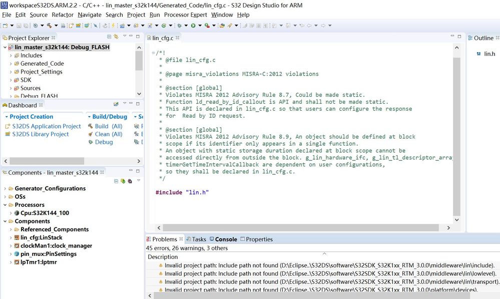

Then I look for the Generated_code, and I find the lin_cfg.c & lin_cfg.h are not intact.
lin_cfg.c:
**     This component module is generated by Processor Expert. Do not modify it.
**     @file      lin_cfg.c
**     @date      10:59:03, 2020-11-23
**     @brief     Hardware configuration file
**     Copyright : 1997 - 2015 Freescale Semiconductor, Inc.
**     Copyright 2016 - 2017 NXP
**     All Rights Reserved.
**     THIS SOFTWARE IS PROVIDED BY NXP "AS IS" AND ANY EXPRESSED OR
**     IMPLIED WARRANTIES, INCLUDING, BUT NOT LIMITED TO, THE IMPLIED WARRANTIES
**     OF MERCHANTABILITY AND FITNESS FOR A PARTICULAR PURPOSE ARE DISCLAIMED.
**     IN NO EVENT SHALL NXP OR ITS CONTRIBUTORS BE LIABLE FOR ANY DIRECT,
**     INDIRECT, INCIDENTAL, SPECIAL, EXEMPLARY, OR CONSEQUENTIAL DAMAGES
**     (INCLUDING, BUT NOT LIMITED TO, PROCUREMENT OF SUBSTITUTE GOODS OR
**     SERVICES; LOSS OF USE, DATA, OR PROFITS; OR BUSINESS INTERRUPTION)
**     HOWEVER CAUSED AND ON ANY THEORY OF LIABILITY, WHETHER IN CONTRACT,
**     STRICT LIABILITY, OR TORT (INCLUDING NEGLIGENCE OR OTHERWISE) ARISING
**     IN ANY WAY OUT OF THE USE OF THIS SOFTWARE, EVEN IF ADVISED OF
**     THE POSSIBILITY OF SUCH DAMAGE.
 * @file lin_cfg.c
 * @page misra_violations MISRA-C:2012 violations
 * @section [global]
 * Violates MISRA 2012 Advisory Rule 8.7, Could be made static.
 * Function ld_read_by_id_callout is API and shall not be made static.
 * This API is declared in lin_cfg.c so that users can configure the response
 * for  Read by ID request.
 * @section [global]
 * Violates MISRA 2012 Advisory Rule 8.9, An object should be defined at block
 * scope if its identifier only appears in a single function.
 * An object with static storage duration declared at block scope cannot be
 * accessed directly from outside the block. g_lin_hardware_ifc, g_lin_tl_descriptor_array,
 * timerGetTimeIntervalCallback are dependent on user configurations,
 * so they shall be declared in lin_cfg.c.
#include "lin.h"

What's going on with this situation?

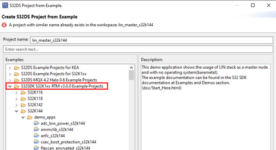

Unfortunately, I cannot reproduce your issue.
I have imported the lin_master_s32k144 and lin_slave_s32k144 example from S32DS 2.2 and S32DS 2018.R1. I'm able to "Generate Processor Expert Code" and compile the projects without any errors.
From S32SDK S32K1xx RTM v3.0.0 Example Projects.
Which S32DS and SDK version do you use?
Thank you.
Diana
6,480件の閲覧回数
larry_he
I tried them both. Unfortunately, neither S32DS 2.2 nor S32DS 2018.R1 can work.
6,464件の閲覧回数

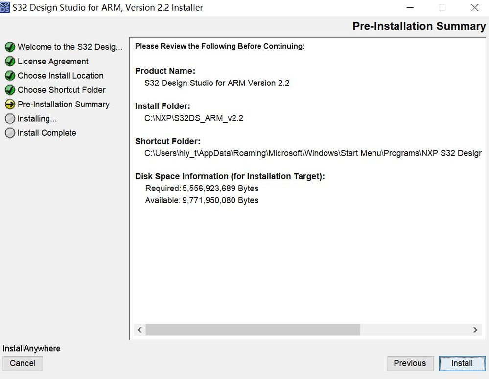

dianabatrlova
Do you use examples from this folder? (here can be found the latest patch for both versions of S32DS https://www.nxp.com/design/software/development-software/s32-design-studio-ide/s32-design-studio-for...)
Can you try to import the attached project into S32DS v2.2 (this project has generated lin_cfg.c)? Have you seen any errors?
Do you use the default installation folder for the S32DS?
Do you have an option to test it on another computer?
Thank you.
Diana

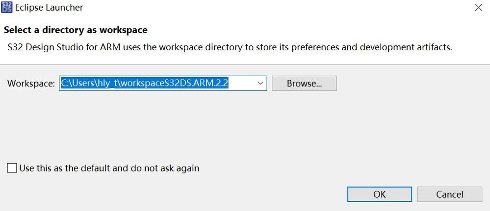

Yes,I download and install the latest SDK.
I don't use the default location of installation. I set it to "D:\NXP_20201122\S32DS_ARM_v2.2",so there is a error when compiling the project which you provided.
make: *** No rule to make target 'C:/NXP/S32DS_ARM_v2.2/S32DS/software/S32SDK_S32K1xx_RTM_3.0.0/rtos/osif/osif_baremetal.c', needed by 'SDK/rtos/osif/osif_baremetal.o'. Stop.
However, I copy lin_cfg.c in your project and put into my project. Compiling maybe successful(no errors).
My friends can utilize those project well via their own install package. Let me have a try to install the package on another computer.

dianabatrlova
Thank you for your details.
If you will try it on another computer, please, try to use the default location for installation if it is possible (just to be sure).
I will wait for your feedback.
Thank you.
Diana

dianabatrlova
Thank you for the details.
Have you tried to reinstall S32DS on your computer with the default installation path?
Which Windows version do you have on your computer?
Diana

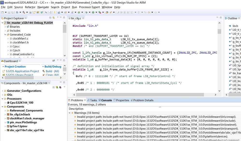

6,415件の閲覧回数
larry_he
This time, I did not change anything.They are all default.
However, the code was still not intact.
My Windows version is listed as below:
Windows 10
1909
2019/8/22
18363.1198
6,377件の閲覧回数

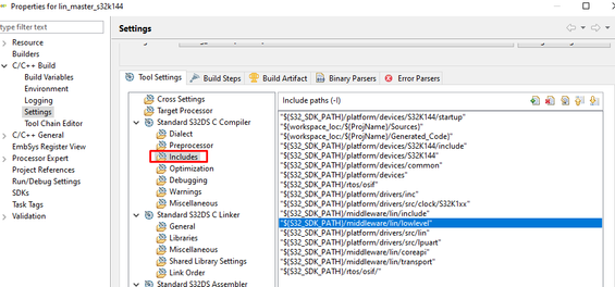

dianabatrlova
Please accept my apologies for the delay.
I can see warnings in your last image related to the LIN path.
This can be fixed by the right click on the project -> Properties -> Build -> Settings -> Includes and select the correct SDK path:
Diana
