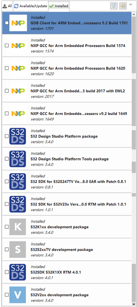

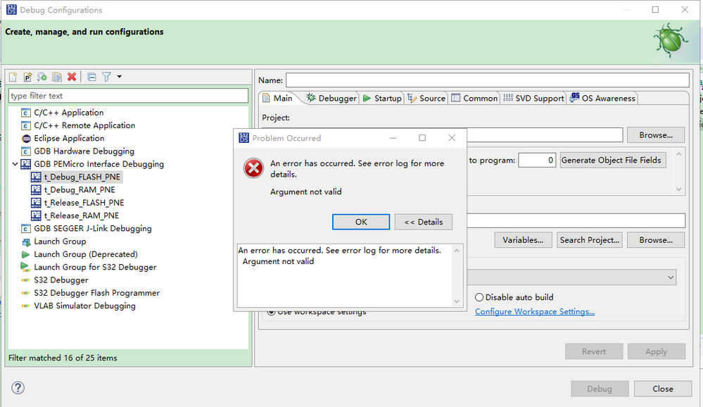

I got an error when I used PE Micro to debug,I have installed these plugins:
S32DS cannot use PE Micro for debugging, the error message is as follows:

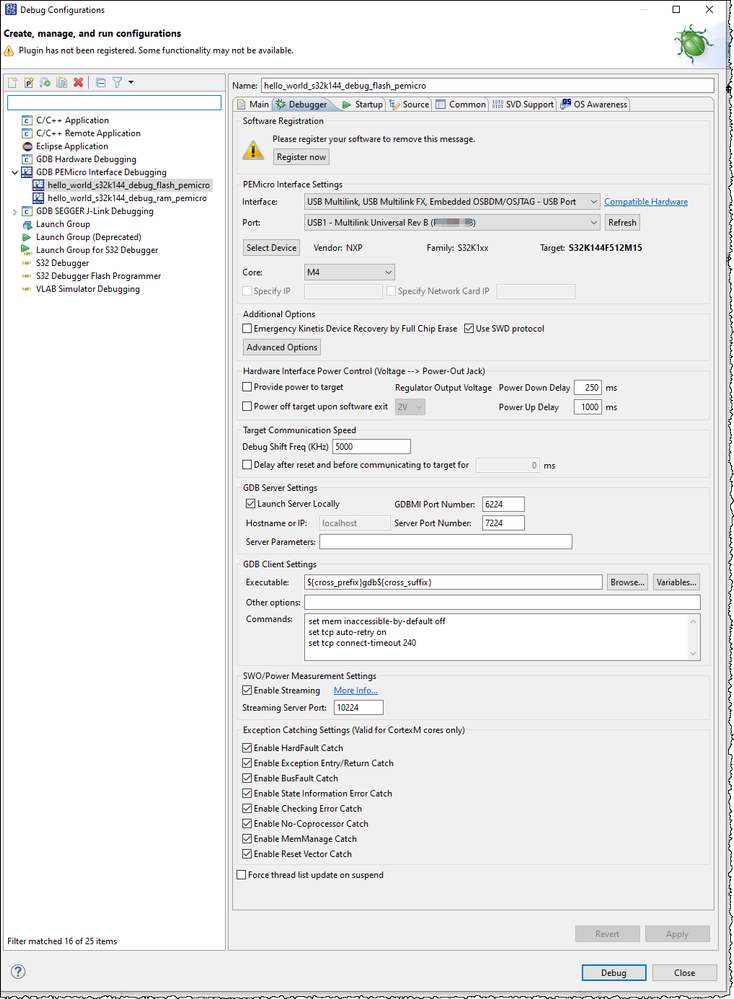

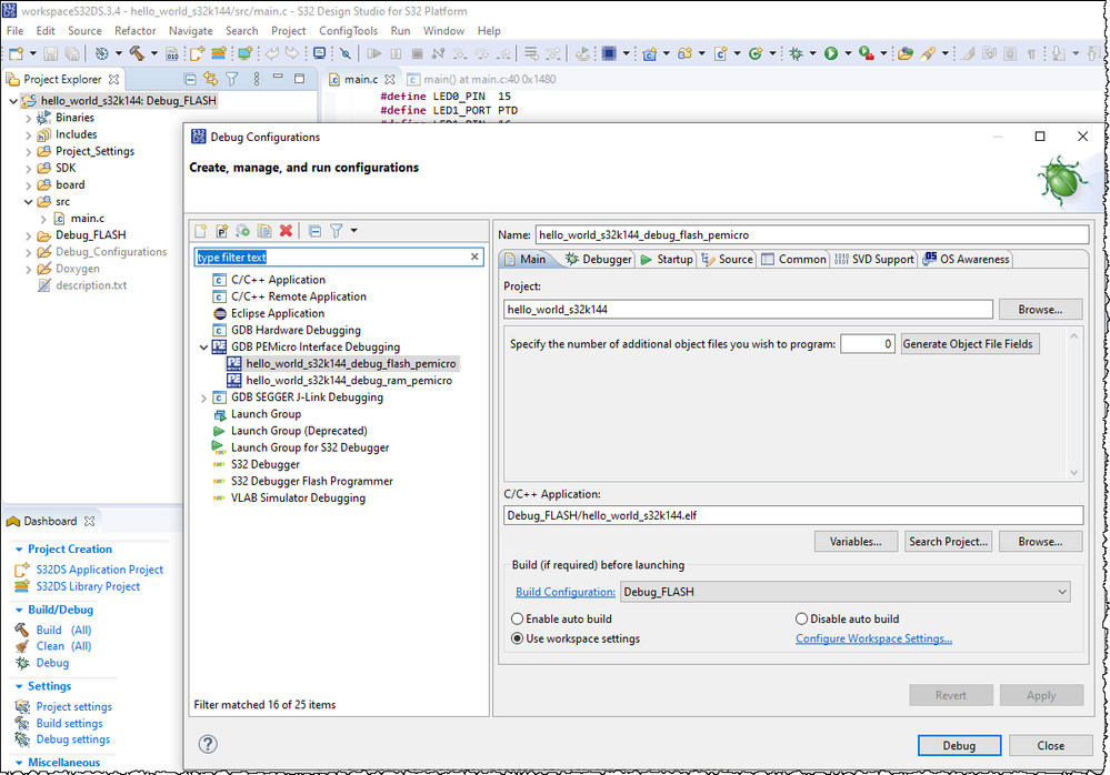

Hi xqcnhz,
Have you try to debug the demo projects in SDK?
I can debug hello_world_s32k144 with onboard OpenSDA and external PE Multilink without issue.
Would you please compare the debug configuration between your project and these demos?
