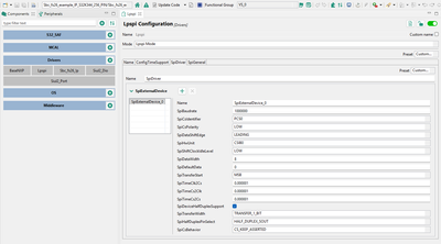

I can see in the  Sbc_Fs26_HLD example that there is an option in the Spi component (MCAL) to set a CS pin, which allows manual control over the CS pin
But I'm not clear where that option is if I don't want to use a MCAL layer.
So, not working according to a AUTOSAR framework.
In the same type of example but in the version Sbc_fs26_example_IP , which is not according to AUTOSAR standard, I don't have that option.
Where is SPI CS as GPIO pin control, option in the non autosar example?
Thank you.

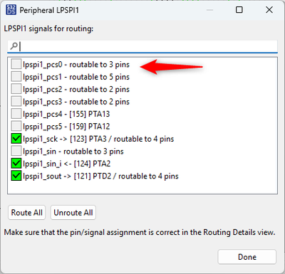

Unlike the SPI driver (MCAL), the LPSPI driver (IP) does not provide an explicit option to indicate whether the CS will be managed via GPIO or by the HW engine. For the IP driver, handling CS through GPIO must be implemented in code, and in ConfigTool you need to configure the desired pin as a GPIO.

How do I configure the CS pin in the S32DS tool to be a GPIO, when it is reserved for a Lpspi peripheral. There is a definition collision. One pin cannot be defined in two different components Lpspi and SIUL. Can you send me a screenshot of where this is exactly set up. I read the documentation, this chapter refers to settings in the AUTOSAR context.

The pin should be configured only as a GPIO, not as an SPI pin. For example, instead of defining it like this in the Pins Tool:
It should be configured as follows:
Then, control the state of the pin using the API Siul2_Dio_Ip_WritePin().

I followed your advice and these are the steps I took:
1) I unrouted a lpspi1_pcs0 pin from the LPSPI1 peripheral
2) I routed the same pin and declared it as GPIO.
3) Before initiating SPI communication with Lpspi_Ip_SyncTransmit, I would first lower the pin (which simulates the CSB) with Siul2_Dio_Ip_WritePin and then raise it high again after Lpspi_Ip_SyncTransmit.
It is Full Duplex communication, SpiPinConfiguration mode 3.
4) SPI communication is not successful. Do I need to set something here (or somewhere else)?
Could you provide further instructions?
