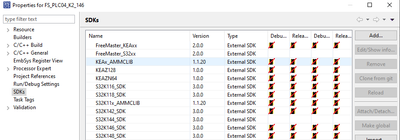

In my project I changed the processor type from S32K144 to S32K146. It all worked until I can't change the SDK.
In the SDK path in the project tree is the right S32K146 MCU.
I also have changed the defined symbols for preprocessor.
But I can't chnage the SDK in the Project settings:
The symbol means:
SDK does not support processor or core required by the project. Cannot attach.
What do I have to do to be able to change the SDK in the project settimgs?

Hi@koehlerl
I reproduced it, it is indeed like this, this really cannot be changed
But this does not affect the compilation of the project, I think this is not a bug,

I have done all the steps from post
https://community.nxp.com/t5/S32-Design-Studio-Knowledge-Base/HOWTO-Change-the-CPU-Derivative-in-an-...
and the project works but the sdk project setting is not right respectively I cannot attach to S32K146.
BR Lutz

Hi@koehlerl
Can you take a screenshot?
In fact, this operation is not very convenient, and some files need to be deleted and added. I suggest to create a new S32K146 project directly, and refer to the configuration of the old project. This work is very simple and there will be no accidental errors.

The sreenshot
I cannot attach the S32K146
