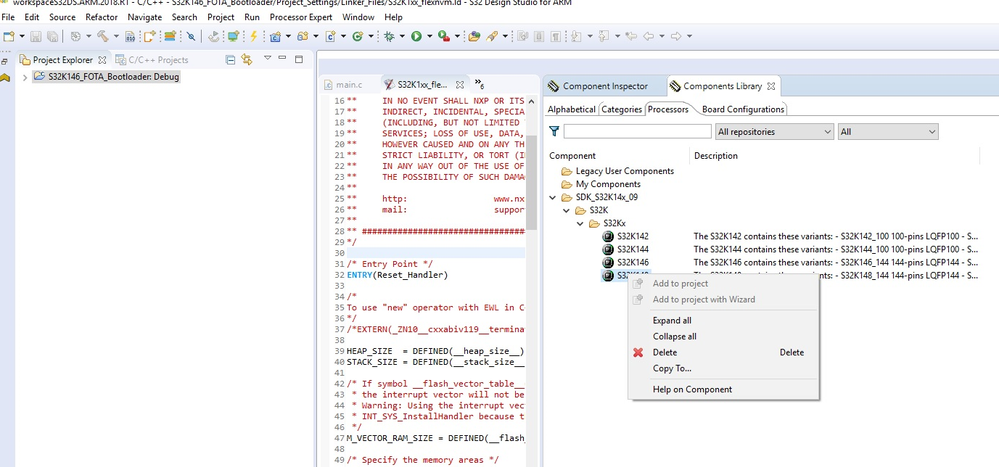

I am working on to  porting the s32k146 project to s32k148. Here I am facing an issue.
In step 3
After double-click OR right-click and select 'Add to project', but 'Add to project' option is not available or shaded out  for me.
Could you please provide input on this issue?

I am facing an issue,
In step 3
Refer the screen shot below.
anybody faced/resolved  is issue,  could you please share the details??
Sathish
Hello sathish.sekar@hsae.eu‌,
Apologies for the late reply. The example project, AN12218SW, is not an SDK-based project. The instructions in this HOWTO only apply to SDK-based projects.
Hope it helps,
Mike

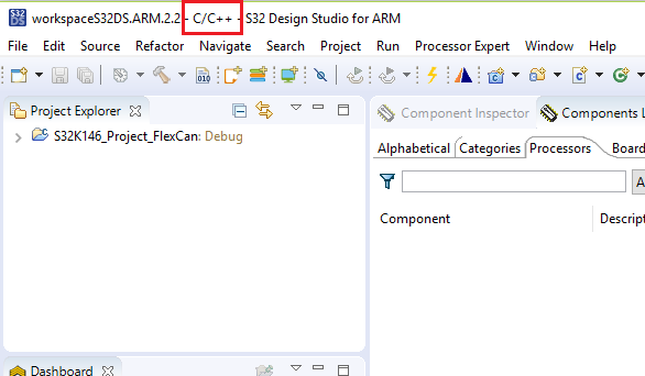

1st line what is select C/C++ perspective
Hello abhishek.k@sloki.in,
The C/C++ Perspective is an Eclipse Perspective. A Perspective in is a collection of views and toolbars that helps you to perform a particular task. The C/C++ Perspective is focused on C/C++ development. You can find more details at: Help - Eclipse Platform
To identify if your currently selected perspective is the C/C++ perspective, look in the title bar at the top.
If you do not see this, you need to switch to the C/C++ perspective. This can be done by clicking on the button in the toolbar at the upper right.
Hope it helps,
Mike
