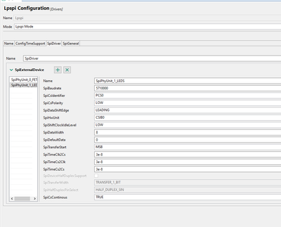

I'm using an S32K344 and I'm not sure how to set which SPI instance to use for a device. How do I set this to use instance 2?
For example here is how I configured the SpiExternalDevice:
When I run the generate code the instance is set to 0
/* Lpspi_Ip_DeviceAttributes_SpiPhyUnit_1_LEDS Device Attribute Configuration of Spi*/
const Lpspi_Ip_ExternalDeviceType Lpspi_Ip_DeviceAttributes_SpiPhyUnit_1_LEDS_Instance_0_BOARD_InitPeripherals =
0U, /* Instance */
(uint32)(LPSPI_CCR_SCKPCS(1U) | LPSPI_CCR_PCSSCK(1U) | LPSPI_CCR_SCKDIV(12U) | LPSPI_CCR_DBT(0U)), /* ccr */
(uint32)(LPSPI_TCR_WIDTH(0U) | LPSPI_TCR_CPOL(0U) | LPSPI_TCR_CPHA(1U) | LPSPI_TCR_PRESCALE(0U) | LPSPI_TCR_PCS(0U) | LPSPI_TCR_CONT(1U)) /* TCR */
#if (STD_ON == LPSPI_IP_HALF_DUPLEX_MODE_SUPPORT)
,(uint32)0U /* This device do not support half duplex mode */
#endif
, &Lpspi_Ip_DeviceParamsCfg_BOARD_InitPeripherals[1U]

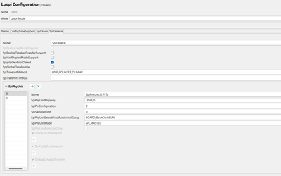

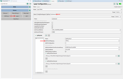

VaneB
Hi @tommy1231
How to set which SPI instance to use for a device. How do I set this to use instance 2?
The LPSPI instances are configured in the Peripherals tool in the "SPIGeneral " tab. The SpiPhyUnit is where you configure the LPSPI instance. I suggest checking the Lpspi_Flexio_Ip_Transfer example so you can get familiar with the configurations and functionality of the driver.

4,350 Views
tommy1231
Hi VaneB,
Thank you for the response. In my case I have 2 SPI phy lines defined. How would I configure which SPI phy to attach the SPI driver configuration to? It seems to just take the first item in the phy list. I will have multiple configurations in the SPI driver and need to assign them to different SpyPhyUnit.

VaneB
Hi @tommy1231
To assign the corresponding configurations to a specific SpiPhyUnit, you need to modify the SpiHwUnit parameter, as shown in the following image.
