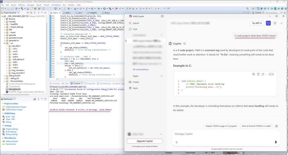

I am following Section 8 of UM 11965 (CANHUBK344), successfully did a offline install of the extensions & imported the sample project and did a build project. It throws multiple errors for the TODOs .. What should we do with the TODOs here, i have the reference kit hardware and in the user manual no mention of these TODOs.  And also once i build the project could you share the link of how to flash the elf file using programmer ?

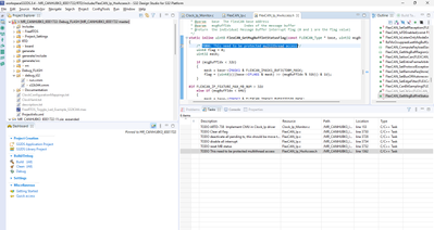

Sorry let me rephrase my issue. The main issue relating to the build errors while compiling the sample code for CANHUBK344. I am following Section 8 of UM 11965 (CANHUBK344) &  imported the sample project and did a build project. It throws multiple compilation errors for the TODOs in the sample code MR_CANHUBK3_IEEE1722   .. What should we do with the TODOs in the sample code here, i have the reference kit hardware and in the user manual no mention of these TODOs.  How do i fix this compilation errors refer below the screentshot sample

I am able to build this project without error
Build Finished 0 errors MR_CANHUBK3_IEEE1722.pngBuild Finished 0 errors MR_CANHUBK3_IEEE1722.png

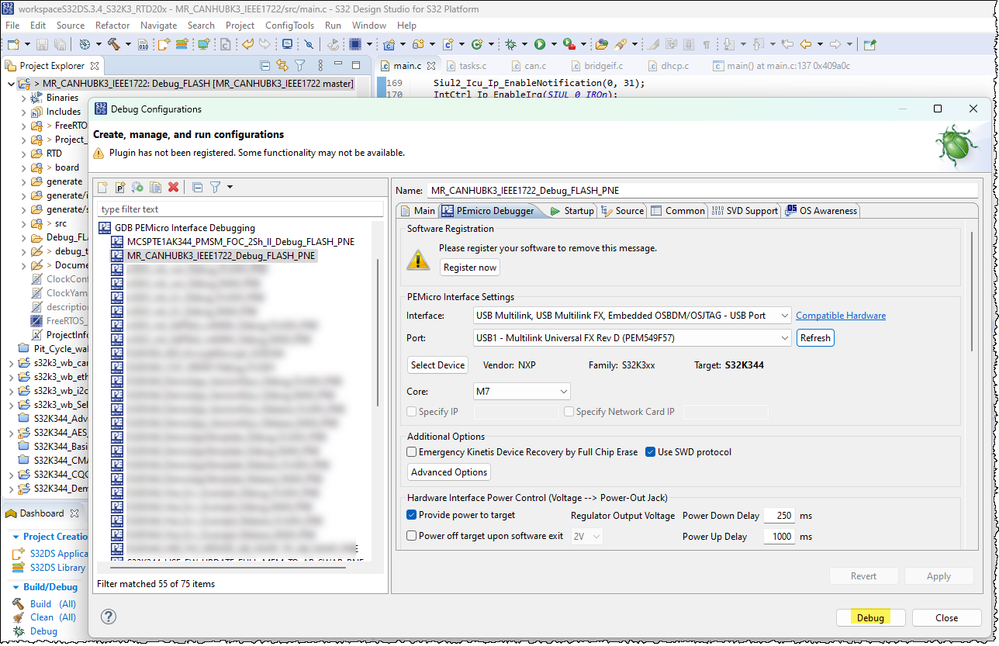

There is no on-board debugger on the CANHUBK344 board. Did you connect external debugger(PEMicro Multilink or Segger J-Link) at P7A?
MR-CANHUBK344 external 12V and Multilink FX debugger - Copy.jpgMR-CANHUBK344 external 12V and Multilink FX debugger - Copy.jpg
If you are using Segger J-Link, please refer to S32 Design Studio for S32 Platform V3.4/V3.5 + SEGGER J-LINK Plus
If you are using PEMicro Multilink, please refer to
