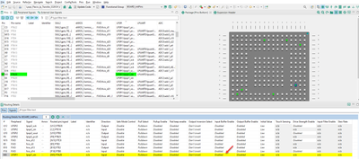

Julián_AragónM
Hi @nehalp,

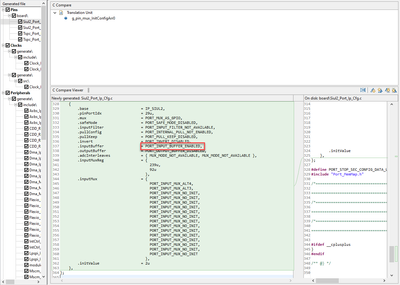

When enabling pin PTA29, is the option for "Input Buffer Enable" enabled? When I add the pin with the following configuration, I can see PORT_INPUT_BUFFER_ENABLED is correctly set:
        .base                        = IP_SIUL2,
        .pinPortIdx                  = 29u,
        .mux                         = PORT_MUX_AS_GPIO,
        .safeMode                    = PORT_SAFE_MODE_DISABLED,
        .inputFilter                 = PORT_INPUT_FILTER_NOT_AVAILABLE,
        .pullConfig                  = PORT_INTERNAL_PULL_NOT_ENABLED,
        .pullKeep                    = PORT_PULL_KEEP_DISABLED,
        .invert                      = PORT_INVERT_DISABLED,
        .inputBuffer                 = PORT_INPUT_BUFFER_ENABLED,
        .outputBuffer                = PORT_OUTPUT_BUFFER_DISABLED,
        .adcInterleaves              = { MUX_MODE_NOT_AVAILABLE, MUX_MODE_NOT_AVAILABLE },
        .inputMuxReg                 = {
                                         239u
        .inputMux                    = {
                                         PORT_INPUT_MUX_ALT4,
                                         PORT_INPUT_MUX_NO_INIT,
        .initValue                   = 2u
