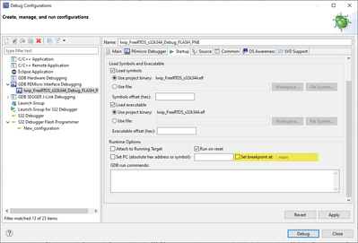

I have a custom-built S32K322 target board along with a PE Micro Multilink probe. Please guide me on how to flash the board using S32 DS.
I'm also trying to debug using the probes, but I'm getting the error as seen in the image attached to this post.
Any help is appreciated.

Hi @pratik_a,
Unfortunately, this version of S32DS does not support the flash tool, only debugging. You could disable the temporary breakpoint at main so the code runs after debugging:
There is also the PEmicro's PROG Flash Programming software, directly from PEmicro's page.

Has this MCU worked prior to trying to flash with PE Micro?
Could you share which connection are you using? Please update the PE Micro plugins for S32DS as well and following this general guide for debugging: HOWTO: Build a Project and Setup a Debug Configuration for debugging in S32 Design Studio - NXP Comm...
There is also this document for USB Multilink and NXP devices: Technical Summary for USB Multilink Universal
Julián
12,411件の閲覧回数
pratik_a
Hi @Julián_AragónM ,
Yes, it worked earlier but I had flashed it with Segger's J-Link Edu mini. But somehow it stopped working. I'm unsure of the reason as of yet. I'm using J-tag to flash and debug, Port G of the PE Micro multi-link device.
I'm also not sure how to directly flash code using PE Micro through S32 DS. I tried to debug using the steps mentioned in the link, but I got the error as seen in the attached image above.
