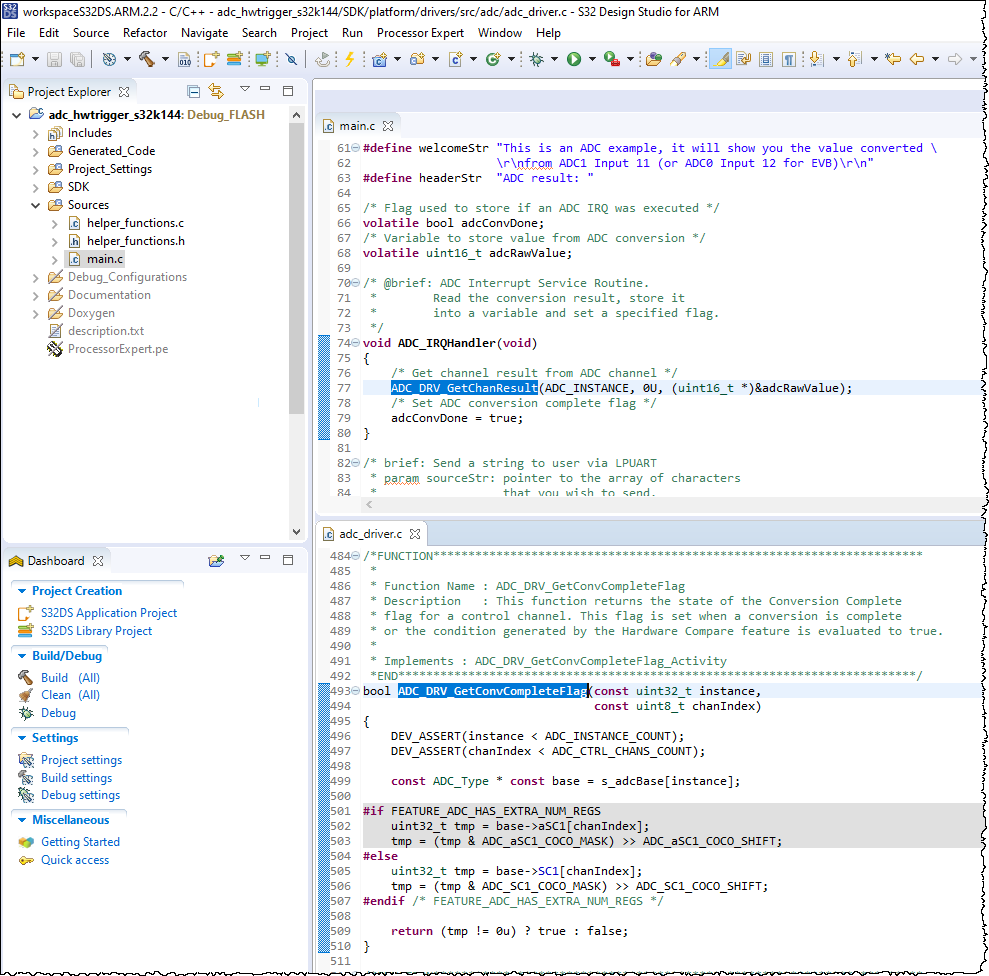

When a conversion is complete, the SC1n[COCO] flag is set. You can read it with the ADC_DRV_GetConvCompleteFlag.
Your while loop call ADC_DRV_GetChanResult too frequency. The ADC may not have finished converting.
Have you refer to those ADC examples in SDK? In addition, this example is also recommended for your reference: Example S32K144 PDB ADC DMA S32DS.ARM.2018.R1
