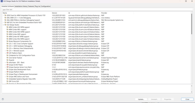

Hello everyone,
I get an error message when I try to install the extension S32k1xx development package:
Operation detailsSoftware being installed: com.nxp.s32ds.s32k1.dev.feature.feature.group 1.0.0.202106101451 Missing requirement: com.nxp.s32ds.s32k1.dev.feature.feature.group 1.0.0.202106101451 requires 'org.eclipse.equinox.p2.iu; com.nxp.s32ds.cle.s32k1.s32k142w.dev.feature.feature.group [1.0.0.202106101446,1.0.0.202106101446]' but it could not be found
Can you help me please? Thank you!

Several customers have successfully installed it after making this modification. So please try it and let me know the results.

Hello! As you said, I found that requirements aren`t installed. I tried to find those by google, but I didn`t. Can you help me with this please?

It is recommended to change Available S32DS Software Sites to httpsPlease refer to the discussion in Where can I find it?S32_SDK_S32K1xx_RTM_4.0.3
