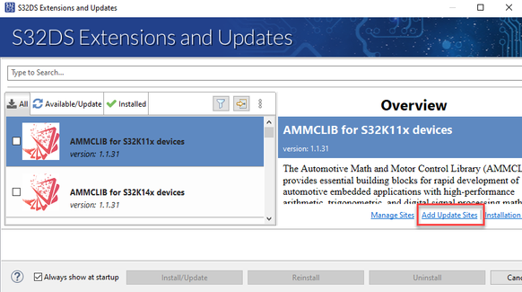

Hello @mark2468,
You need to install the S32 Design Studio 3.5.0 development packages for offline use, support for S32K3xx, S32K358 and S32K388 package
https://www.nxp.com/products/processors-and-microcontrollers/s32-automotive-platform/s32k-auto-gener...
Automotive SW - S32K3 - S32 Design Studio
3.5.0_D2212 S32 Design Studio 3.5.0 Development Package with support for S32K3xx devices 
Download SW32K3xx.S32DS_3.5.0_D2212.zip
Add it as an Update site
After that, you should see it in the Available/Update list
BR, Daniel

mark2468
I added the package like you described above. The S32K388 is now available which is good. However, I still cant do the pin configuration as there is no SDK in the drop down list when I create the project.
Do I need to add something else for this?
Thanks.

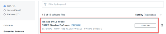

danielmartynek
Hello @mark2468,
The library requires RTD 2.0.1.
It might be in the list already, if not, you can find it again in the Standard Software
Automotive SW - S32K3 - Real-Time Drivers for Cortex-M
S32K3 Real-Time Drivers Version 2.0.1
