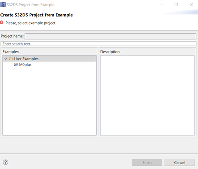

I recently downloaded the S32 Design studio 3.4 but I couldn't find any example projects:
Is there a problem with my installation or does this version come without example projects ?

Seems that you are using S32K1x, please install the latest S32 SDK for S32K1xx RTM 4.0.3 in S32DS 3.4 using Extensions and Updates  by refer to the discussion in How to connect SDK Version 4.0.3 to S32DS

Okay so I can find the following in extensions and updates and I need to make sure I am installing the appropriate one:
1 - S32K1 RTD AUTOSAR 4.4 Version 1.0.1
2 - S32SDK S32K1XX RTM 4.0.3
Do they both contain example projects but one is autosar based and the other isn't ?
Or does only the S32SDK S32K1XX RTM 4.0.3 contain example projects ?

Both contain example projects. The newer RTD combines SDK and MCAL environments in one software product.
