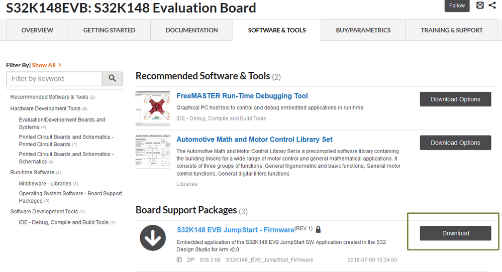

Have you reprogrammed the MCU? If so, you erased the pre-loaded RGB firmware (S32K148 EVB JumpStart).
You can download the project from the S32K148EVB product web page and load the MCU again in S32 Design Studio.
S32K148 Evaluation Board|NXP

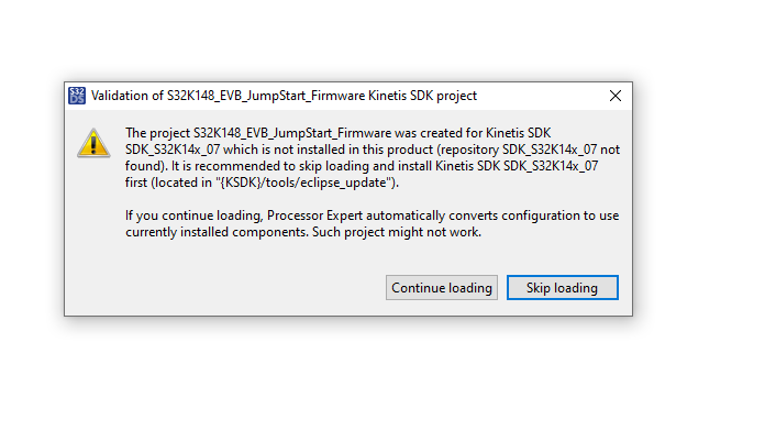

suresh_jayagond
Hi I have same issue, and when i try from SDK studio i get below error
