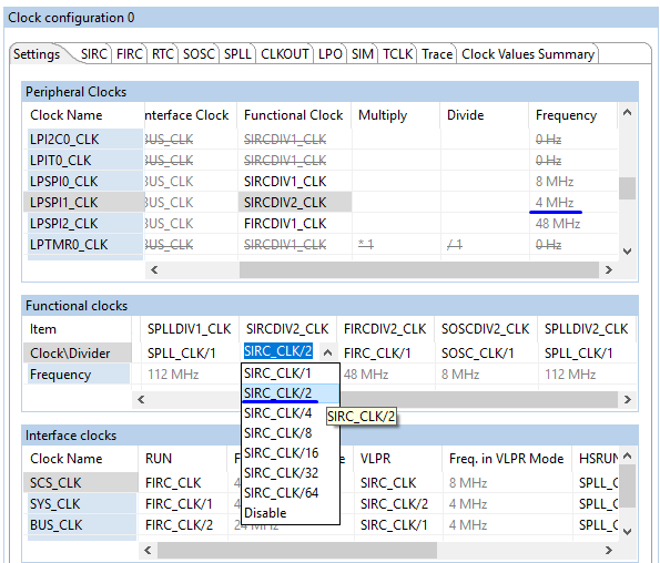

4. Processor Expert shows incorrect frequency for divided clocks:
I.e PE shows 8MHz for both SIRCDIV1_CLK and SIRCDIV2_CLK. Same issue for all other clocks in the list.

I have just check the PE clock configuration.
I don't see any problem with that. Both dividers can be set in the Functional clocks window.

maksimsalau
Many thanks, Daniel!
I've interpreted names incorrectly. I thought that SIRCDIV2_CLK == SIRC_CLK/2 but it is just a second option, and the actual division factor is configured elsewhere.
