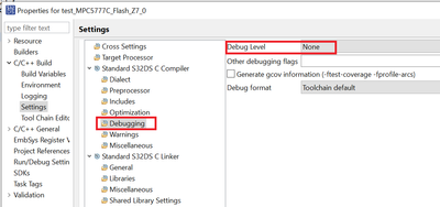

Hello.
I made '.a' file from s32ds ide (s32ds library project)
Now i need to remove symbol information in made '.a' file.
Changing makefile or changing project property might be solution...
(I prefer the way changing project property)
But I don't know.
Please help me
Best Regards
Phillip

Hi Phillip,
If you have a separate library project I'd suggest you to switch off the debug information in the project properties -> compiler settings and rebuild the library.
Hope it helps.
Stan
