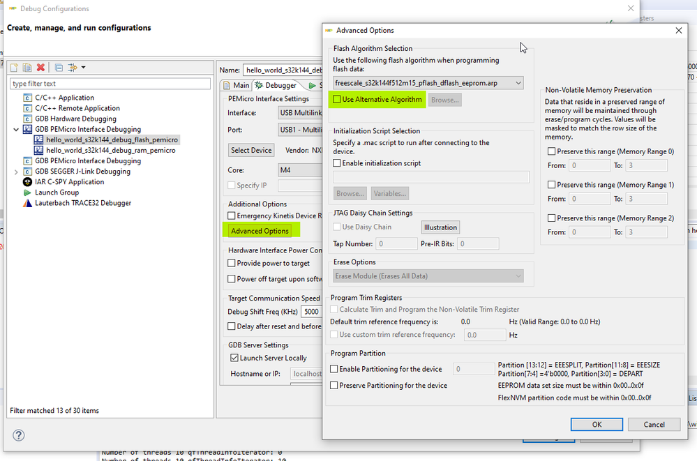

I'm using Multilink Universal FX with firmware Version 10.70 to debug on S32K144 by using S32 Design Studio for ARM Version: 2018.R1 Build id: 180815
Upload code & start successfully, but when I press Suspend,
The debugger Console says:
Remote failure reply: E0040000A5A5A5A50000001004ED00E0A5A5A5A5A5A5A5A5A5A5A5A5B8EAFF1FA5A5A5A5A5A5A5A5A5A5A5A5A5A5A5A5A5A5A5A5B8EAFF1F3DA8010054A8010000000021C06F002038E7FF1F00000002000000000000000000000000000000000000000000000000000000000000000000000000000000000000000000000000000000000000000000000000000000000000000000000000000000000000000000000000000000000000000000000000000000000000000000000000000000000000000000000000000000000000000000000000
After this, the session (at least on GDB side) gets screwed, and I cannot stop/continue or single step, and have to kill it.
Any idea on this error code meaning?
thanks a lot.

thanks for sharing .elf file. I tried it and on my side it works. Are you using default programming algorithm?
Can you please share full output from pegdbserver_console? Are you using NXP EVB or custom board?
Jiri

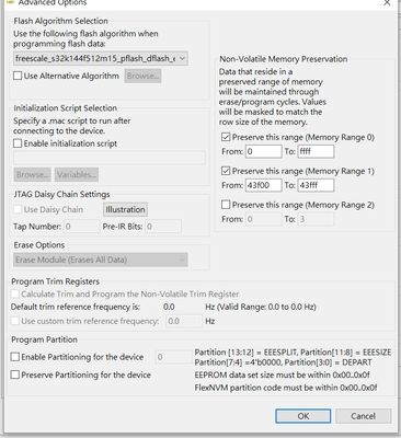

huangkenny
Hi Jiri,
I'm using a customized board with S32K144.
The default algorithm is using.
Full logs:

jiri_kral
Hi Kenny,
what happends if you turn-off the memory preservation?
Jiri
