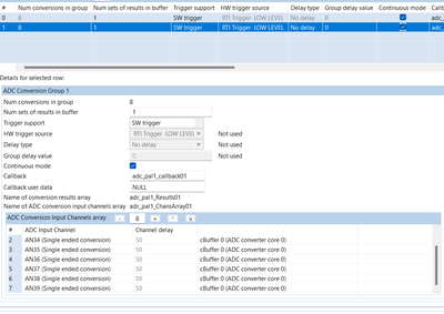

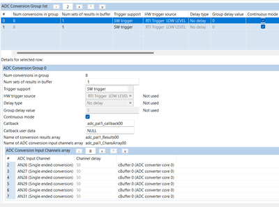

i am working on  PAL EQADC of mpc5777c(416 pin).the example which is given by NXp for group conversion 0 is working fine. but when i want to improve this to further level i am facing below issues.
1.I increased the channels to 8 because of this callback function is not called as it do for 4 channels.
2.When i configure the group conversion 1 as 0 given by Nxp.it also not working as expected.
Please let me know how to configure these and use it efficiently. Thanks in advance for your time and patience.

Configured as Below in processor expert for group conversion 0 and 1.

i am working on PAL Eqadc of MPC5777c.SDK example code which was given by NXP for pal Eqadc shows us   to work  with group conversion  0  of Eqadc 1 which involves  four channels.for this call back is working properly and conversions are also happening fine.Below are problems which i am facing.
1.When i increase the channels of group conversion  0  more than 4 ,call back happens only one time where as it should happen continuously. Please  let me know how to make this callback happen continuously.
2.Similar to group conversion  0 ,if i implement group conversion  1 its not working properly as group conversion  0.Please guide me how to make this group conversion  1 also  working as group conversion  0.

I tested it finding that eQADC module is facing RFIFO overflow and CFIFO underflow. I am not sure why it happens. Generally it happens when conversion trigger is asserted and there is no commands if the CFIFO or RFIFO is full of un-drained results.
If is possible that under SDK environment re-triggering (in continuous mode automatically) happen too fast. Also DMA controller should have priority over CPU.
