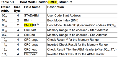

Hi, For NXPs32k342 , I need Boot mode Header structure and Boot Mode Headers locations for configuring memory organization blocks for bootloader , that particular startup software and Boot mode header structure and Boot Mode Headers locations i can't found in NXP S32k3xx reference manual so please help me for getting same. Thanks & Regards, Pragadeesh.

But actually I need to know how the memory is derived for the boot mode header structure and boot mode header location so that it will help me to map the Boot manager header address to logical block in configurator.
For your reference I have attached two screenshot of Boot mode header structure which are ,with respect to other controller .like that  in NXP Reference manual  please give info about where I can find this detail .

Take a look at chapter 31 Boot Overview section 31.3.1 Memory map of S32K3xx Reference Manual, Rev. 5.
