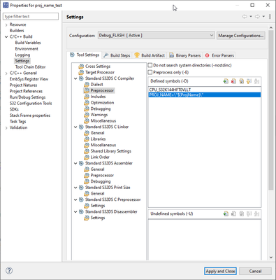

I want to know how can I read the name of the project from the code.
For example, if I have a project with name "MyProject", I want to read the name and store this string in a variable.
Thanks in advance.

Thanks Lukas!
I tried this but got some errors.
After searching for a while, I found this:
https://community.nxp.com/t5/S32-Design-Studio/Macros-to-access-filename/m-p/1073809
Thanks again for your help!

you can use following:
And then in the code something like:
Hope this helps.
